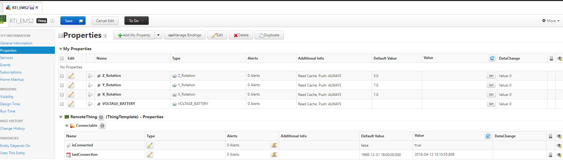

Remote thing properties bind but won't update
All config and template files attached in the zip file. The properties correctly readout when printed from the luascriptresource - I just can't get them to update in composer
Hi @Spencer_Brock which EMS version are you working with?
I feel you are missing some fields in your config.lua file.
If you can please try below config.lua file,
