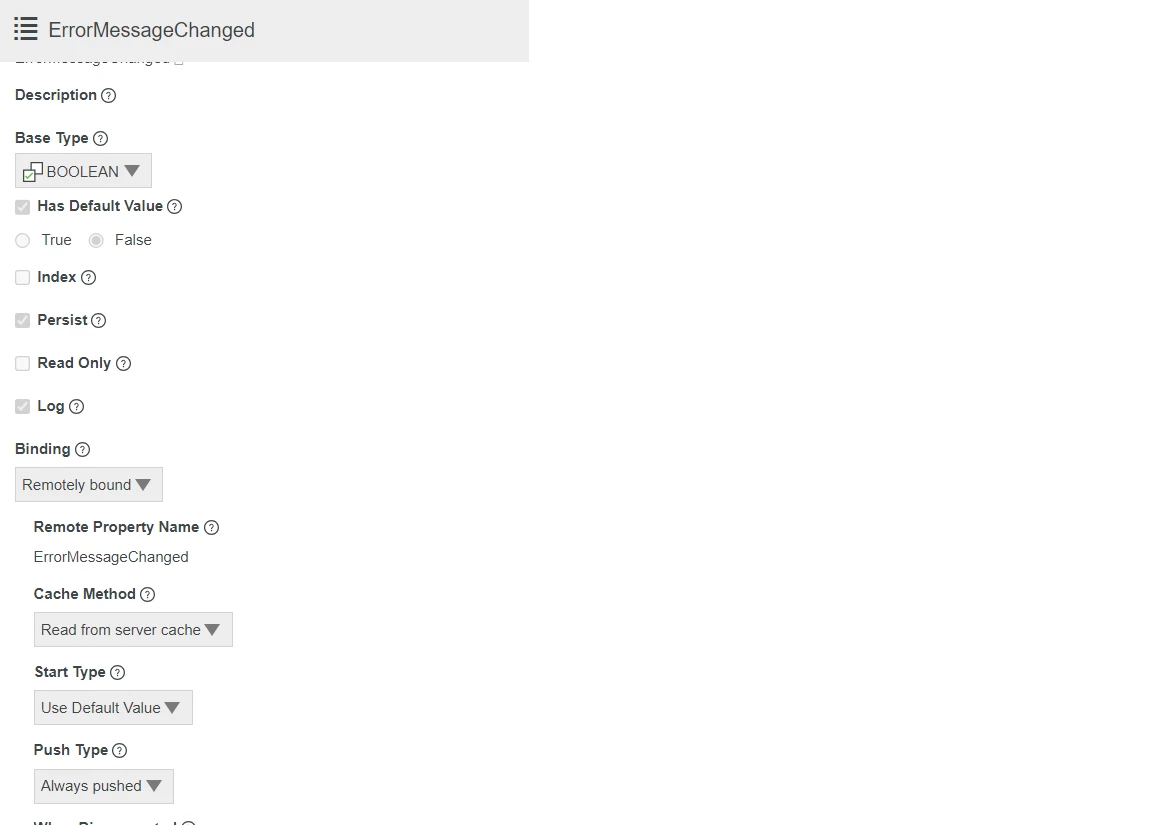

We have a Remote thing, in which we have set of the properties, and it is remotely bound to Edge Thing.
So far everything is good, but when we set the values for properties from Lua script (Edge Side), These values are not reflecting in Thing Worx Platform Side automatically. Every time we have to open a property page from composer and hit refresh button to see the property change value. Why are the values not updating automatically? How to overcome this?
I have provided sample configuration and settings for one for the property called "ErrorMessageChanged" for your reference.
Lua Script this is how property has been initialized:
properties.ErrorMessageChanged = { baseType="BOOLEAN", pushType="ALWAYS", value=false}
Lua Script this how the property has been Set:
properties.ErrorMessageChanged.value = true
ErrorMessageChanged Property configuration on Thing Worx platform side has been attached.

@TS_10150564 TW composer page will not automatically update property value unless you hit the refresh button, however the property value could change background.
First we need to know if property is udpated or not. To confimr that, can you define a DataChange event to see if property value changed or not?
