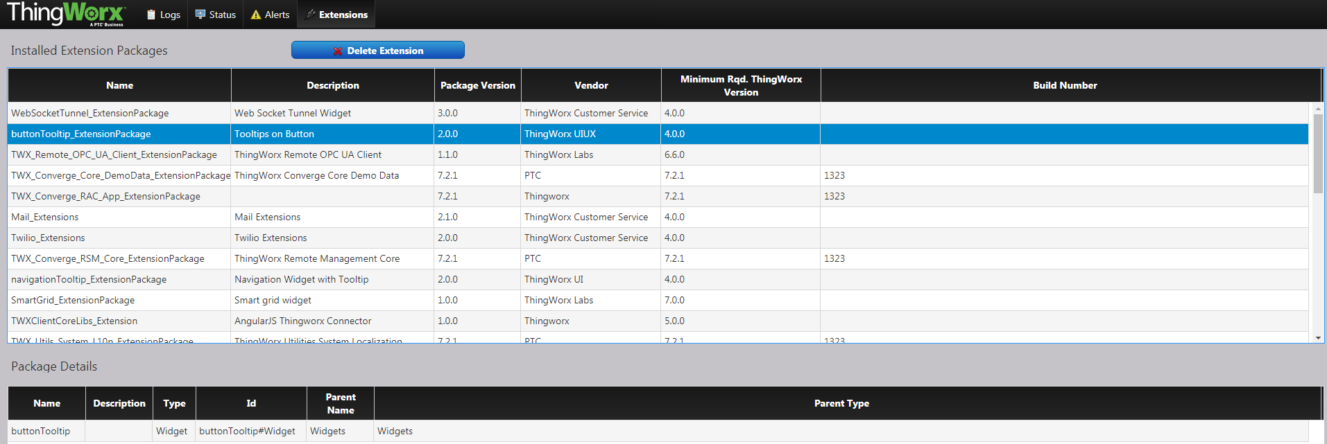

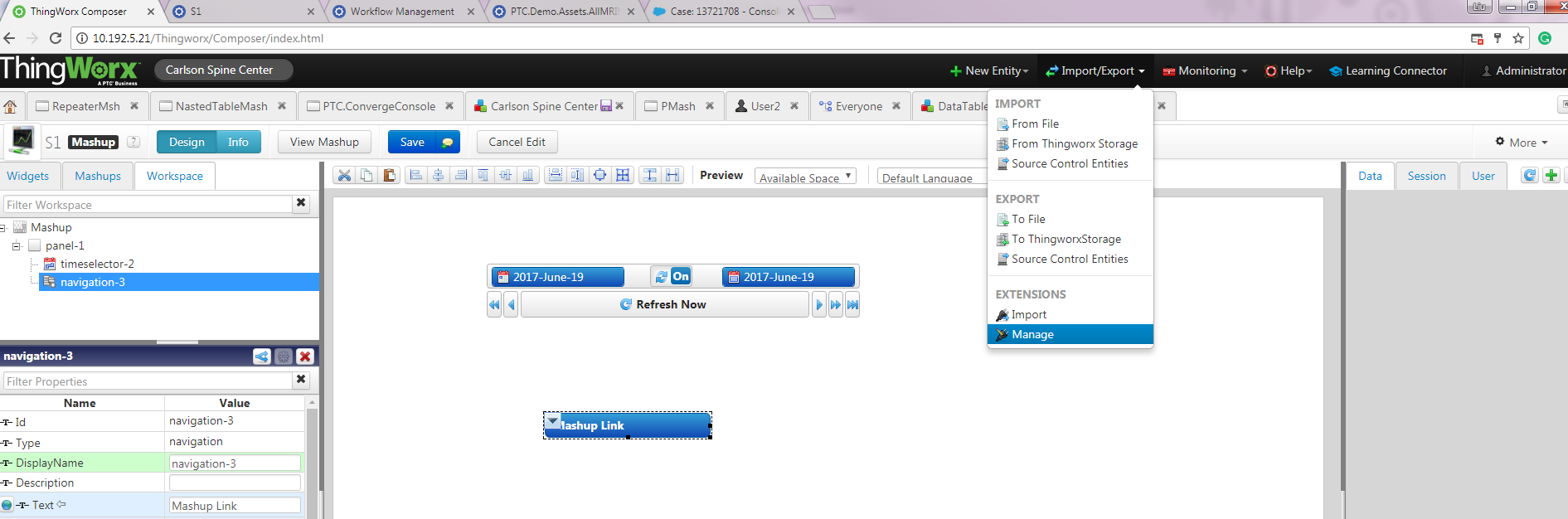

Please login as Administrator, Click Import/Export -> Extension (Manage)
Select the extension that you want to deleted and click the Delete Extension button
I also suggest to restart tomcat after you delete the extension.
