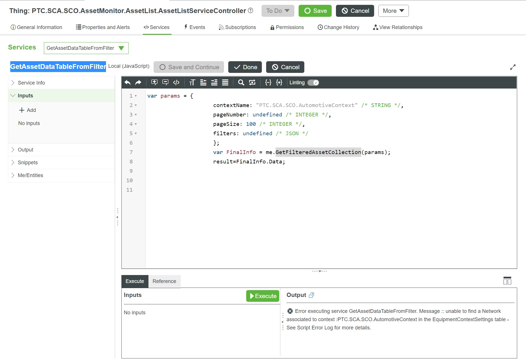

Hello Developers,
I am new to thingworx 9.0 and trying to build an asset monitoring dashboard in Thingworx app on thingworx 9.0. I am trying to fetch list of assets as mentioned in one of the PTC provided exercises (Manufacturing App) by running service 'GetFilteredAssetList' in thing PTC.SCA.SCO.AssetMonitor.AssetList.AssetListServiceController.
Since i am trying to get similar result in Thingworx 9.0 by running service 'GetFilteredAssetCollection' in PTC.SCA.SCO.AssetMonitor.AssetList.AssetListServiceController, it is not returning any data.
Can anyone please help me in getting replacement of this thing.

The error message you received indicates there is no network for the Context given. The network links the context to the equipment structure. Please check if the context was set up properly.
https://support.ptc.com/help/thingworx/apps/r9.0/en/#page/thingworx_apps%2FCustomizing_the_Apps%2Fmanaging_contexts.html%23wwID0ENYHQ
