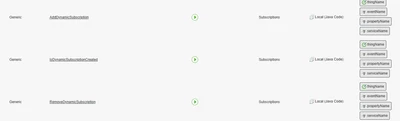

one idea would be the subscription approach, but with dynamic subscription
like when a alert happens you check if subscription already exists, if not add one. on alert reset remove the subscription. and in subscription code you do what ever u need to do.
