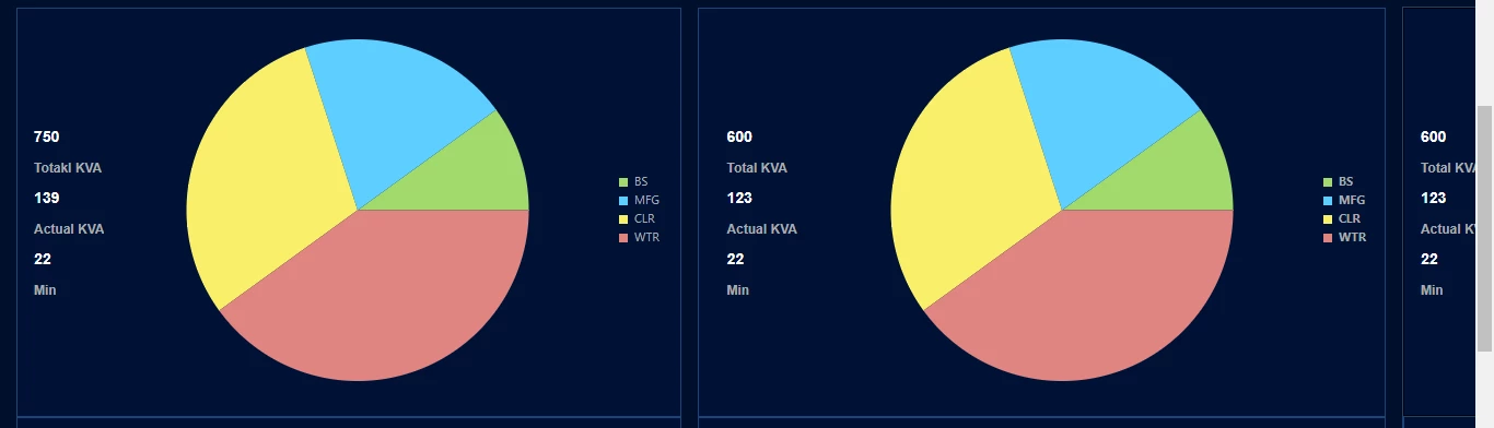

I want to add 3 pie-charts in one row which should be responsive. Tried creating a responsive  size container and add 3 responsive size containers with piechart each. However, this results in scrollbar at each container as size of pie chart is not changing as per container  size. this works well with line chart and there are no scroll bar. How can we resize piechart size as per container?
Attached is the snap of result we are getting

Hi, Please share which version of thingworx you are using? Are you using any panel?
Just select the container and check the layout tab if it is responsive or static. I checked with 9.1 its working for me. Share the mashup xml if possible.
