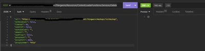

When trying from Insomnia (and running the service from the composer), nothing really happens. I get a response 200 back in insomnia, but the entity still remains. Perhaps my request is wrong?

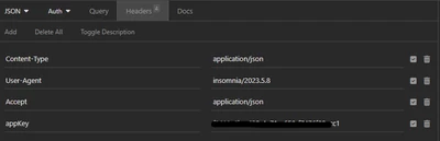

Body:
Header:
The reason why I am using the contentloader for deleting this entity is because there is no entityservice to delete mashups (and some other entity types).
If you know of any other services that can actually delete stuff like mashups, menus etc, then I'd be happy to give it a shot though!

(you are doing a POST request in your screenshote instead of a DELETE request)
edit: ah I just noticed you call the contenloaderfunction service. so POST would be ok. But why not bypass the ContenLoaderFunction and call DELETE on
'.../Thingworx/' + entity.type + "s/" + entity.name
I think this was the idea if this even works
