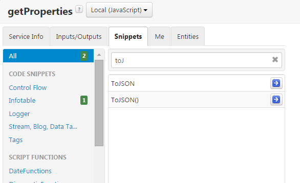

Hi Dean,
You can use inbuilt function ToJSON  which is provided under snippets  to convert output of service into JSON objetct/format.
deanm1-VisitorAuthor
Feb 26, 2016 3:03 PM UTC
Maneesh,
Thanks for your response, but that method is on ThingWorx objects, such as InfoTables, but is not standard JavaScript methods, so it will only work with objects that I've also defined in ThingWorx as a Template or DataShape and then instantiated within the service code.  I don't want to have to do that dual maintenance of objects (both as a ThingWorx object and as a JavaScript data structure) because that quickly becomes a support nightmare when the customer asks for changes to a response and those changes need to be implemented in multiple places.  (Note that I am dealing with responses from a third party customer's software, as opposed to my own company's software, so I have less control over what may be needed/desired on the responses in the future.)
I would prefer to only have to define the structure once in the JavaScript service and then return that structure as a JSON object without a bunch of extraneous ThingWorx wrappers on the JSON.
