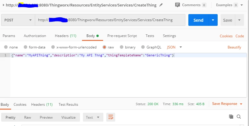

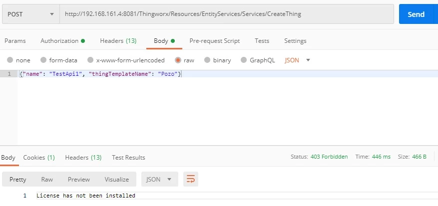

I have a customer using Thingworx 8.5 on Linux with Postgres and using a temporary license,
They can create things using the composer, no issues, but whenever they try to create a thing using the REST API, they get an error saying that "LICENSE IS NOT INSTALLED", as you can see attached,
Please, any ideas?

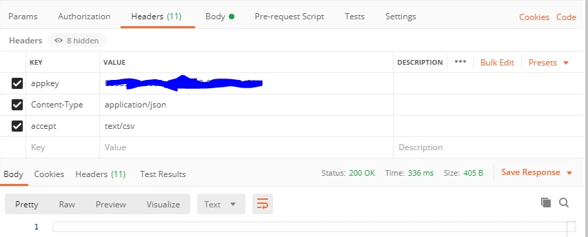

I have not tested this with a temporary license. Please review my settings and compare to your Postman configuration.
Transaction:
POST   http://<IP  Address>:<port>/Thingworx/Resources/EntityServices/Services/CreateThing
In the Headers Tab
  • appkey   :  <your app key value>
  • Content-Type : application/json
  • accept : text/csv
In the Body Tab
  • raw
  • {"name":"MyAPIThing","description":"My API Thing","thingTemplateName":"GenericThing"}
The value for the AppKey is from ThingWorx "Browse -> Security -> Application Key -> <keyname>"
The AppKey needs to be associated to a user which has the privilege to create things.
Let me know if this helps.
