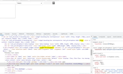

@JO_9930585 Add a value for the CustomClass property for the dropdown widget. When you inspect the dropdown widget after adding the custom class it looks like following('abnew' is the customclass I added):
You can select and apply custom css in the mashup to the carrot icon(element highlighted in grey) using the following Css :

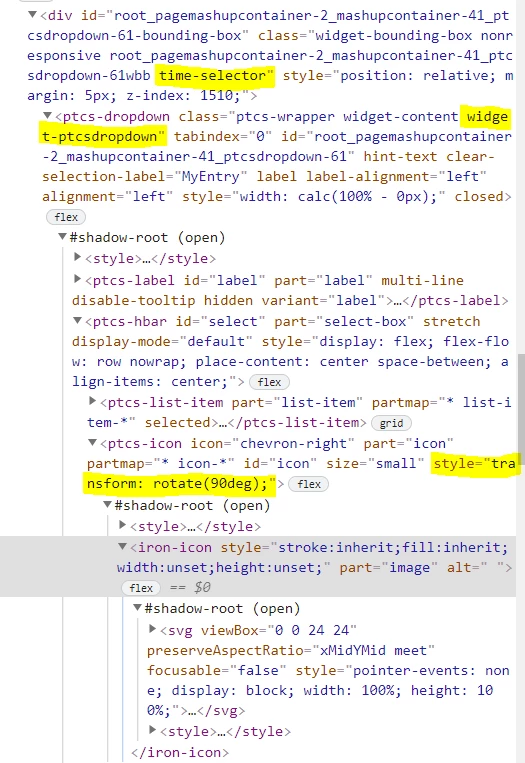

@abjain  And here is the html in chrome dev tools. The transform says 90deg even though I set it to 0deg. So it seems to not be working properly?...

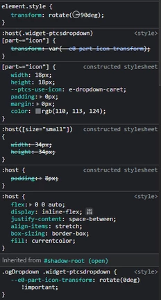

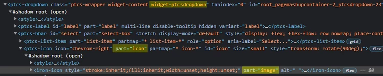

The problem is that the ShadowDOM part has the transform inline, instead of a generated CSS selector. All the CSS you write with ::part() generates variables. Variables don't transfer the "!important" part of your rule. They only retain the value. For example if your variable is "rotate(0deg) !imporant" it will only read "rotate(0deg)". And given the fact that the transform is inline, there is no way to overwrite it but with an "!important". And there is no way to do that.
You can see here that rotate(90deg) is the inline. Next one is my "::part(icon) { transform: rotate(0deg) !important}" rule and it still won't overwrite it. The whole point of these ShadowDOM widgets was to not write inline CSS on them like the old ones.
BUT, there is a fix for this. I've done this in 9.2, so I hope it works for you.
.ogDropdown .widget-ptcsdropdown::part(icon)::part(image) {
 transform: rotate(-90deg);
ogDropdown is my CustomClass on the widget. What I've done here is go a level deeper into that "icon" part to the "image".
The output CSS looks something like this, which is the most hideous thing you've ever seen, but... it works.
