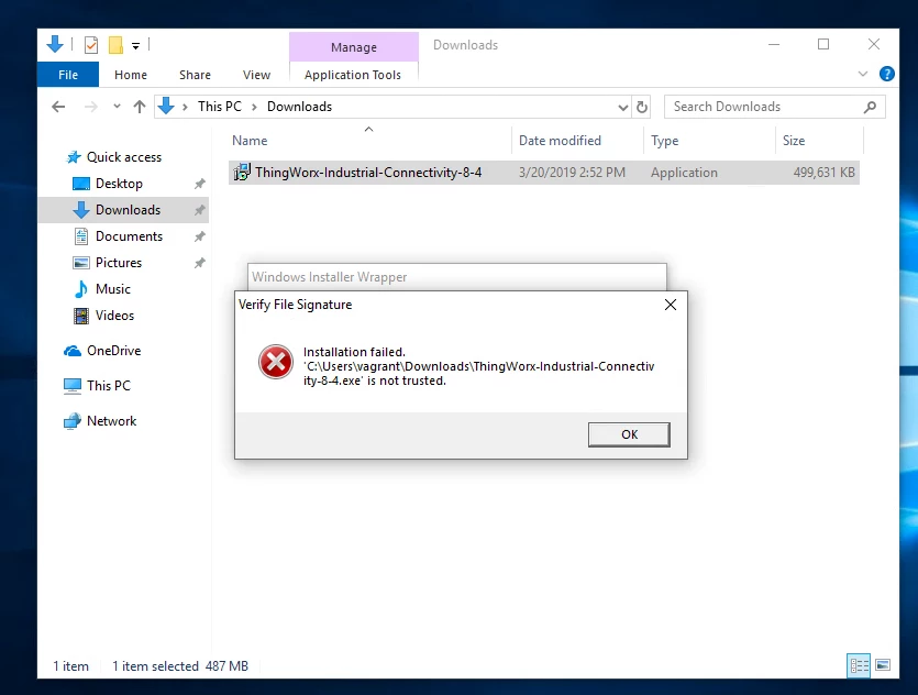

Running Connectivity.exe install fails with "... is not trusted"
When I try to run the connectivity installer on windows I get the error
Verify File Signature
"...-Connectivity-8-4.exe' is not trusted"
Some windows magic required to install? I don't see anything in the install docs.

June 21, 2019
The install error was for an exe file mounted in a vagrant launched VM. The actual zip was downloaded and the exe extracted on ubuntu. The directory with the exe was mounted in the VM at /vagrant.
So I re-downloaded the zip directly in the VM, and extracted it in the VM. That extracted exe does run (no signature error).
Not sure what the issue was the mounted exe. But it's clearly nothing to do with thingworx.

memelet1-VisitorAuthor
June 21, 2019
> I tried to look around for "Connectivity-8-4.exe" but was unable to find anything.
It was "...-Connectivity-8-4.exe", which was short for "ThingWorx-Industrial-Connectivity-8.4.exe" (sorry)
trial downloaded from https://developer.thingworx.com/en/resources/downloads/indconn-trial-edition
docs:
https://www.ptc.com/support/-/media/B14097FDDD9B42868B89B17B1457DAE5.pdf?sc_lang=en
http://support.ptc.com/WCMS/files/173084/en/tw-industrial-connectivity-install-guide.pdf
June 21, 2019
Hello memelet,
Thank you for the quick response here.
This seems to be a common issue with Windows 10 and newer machines.
Lets try to have you execute the installer from an Administrator Command Prompt and see if this error persists.
If it does we may need to temporarily modify UAC settings to get it installed.
June 21, 2019
The above was on windows server 2019. I then tried windows 10. Same problem. Not able to install.
