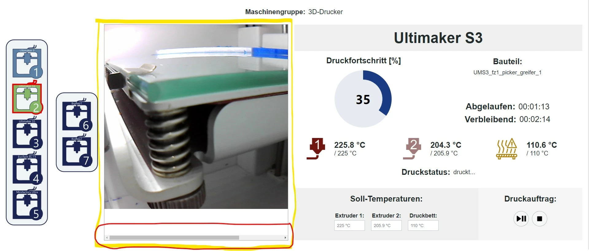

I have included a simple video stream into a mashup via the thingworx web frame. Unfortunately, the stream does not scale with the size of the widget, but is integrated in its full resolution (fullHD). The web frame compensates this via scroll bars. So you can't see the full video and the scrollbars doesn't look nice either.
Is there any possibility to scale the video for example via custom css? Is it even possible to make this responsive?
Also, I have positioned the camera of the stream upside down. Is there any way to rotate the video stream?

thanks a lot! Finally it worked. Here is the code to scale and rotate a videostream for documentation:
.widget-webframe-frame{
 transform:scale(0.8) rotate(180deg) translate(-100px, -78px);
 height: 600px;
 width: 800px;
