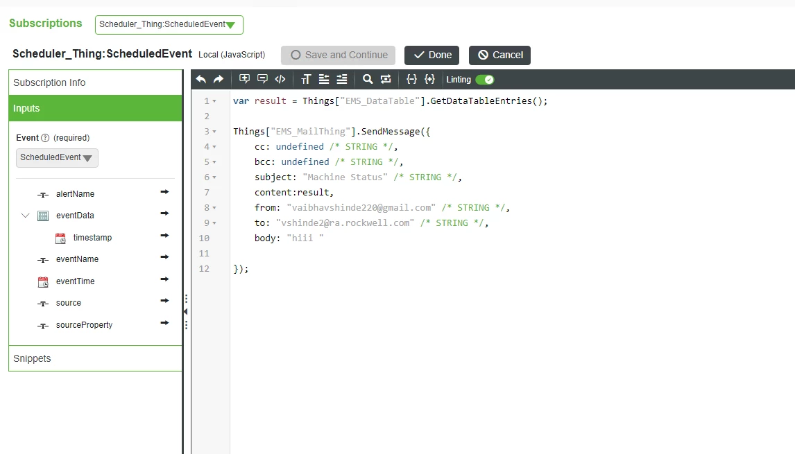

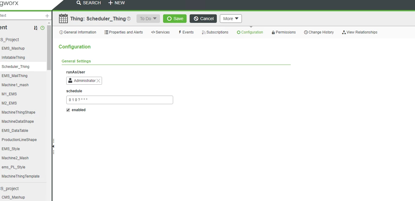

Hi rosharma,
thanks for response. but I am doing something wrong . could you check screenshots attached? subscription code is not executing (I think scheduler is not working), I am not getting any error or warning as well. could you help ?
Thank you

with default cron string 0 0/1 * * * ? which runs every min, the scheduler at my end is running fine. i just checked by put on loggers to services ( logger.warn("inside scheduler script") and it prints every min at my instance. though i haven't tested with email thing as currently i don't have Mail server setup here. but scheduler does work i can say.
i think couple of thing you can test/verify
first , see if subscription is enabled - check that on subscripton info tab under services
you can also try just by providing the loggers in subscription and see if it works.
try manually executing the EMS_MailThing sendmessage service directly from EMS_MailThing -- if this works here then it should also work from subscription as well. if it doesn't then could be issue with this sendmessage service -- may be at first up you just try sending simple text/string to "content" rather than sending whole result infotable to it.
