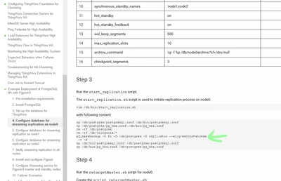

I'm trying to configure a database with replication streaming.
I have three nodes. Red Hat 8.2
Thingworx is version 8.5.4
I'm following this guide https://support.ptc.com/help/thingworx/platform/r9/en/index.html#page/ThingWorx/Help/ThingWorxHighAvailability/ExampleDeploymentofPostgreSQLHAwithPgpoolII.html#
When I run the script /db/bin/start_replication.sh in the first node (master) I get this error:
[postgres@MACHINE0 db]$ sh -x /db/bin/start_replication.sh node0
+ cp /db/postgres/postgresql.conf /db/bin/postgresql.conf
+ cp /db/postgres/pg_hba.conf /db/bin/pg_hba.conf
+ rm -rf /db/postgres
+ rm -rf /db/thingworx/install /db/thingworx/PG_9.6_201608131 /db/thingworx/platform-settings.json /db/thingworx/Thingworx.war /db/thingworx/update
+ pg_basebackup -h node0 -D /db/postgres -U replicator --xlog-method=stream -v -P
pg_basebackup: FATAL: no se pudo abrir el archivo de mapeo de relaciones «global/pg_filenode.map»: No existe el fichero o el directorio
+ cp /db/bin/postgresql.conf /db/postgres/postgresql.conf
+ cp /db/bin/pg_hba.conf /db/postgres/pg_hba.conf
The database is runing in this node.
The /etc/hosts is
10.98.146.20 MACHINE2 node2
10.98.133.93 MACHINE0 node0
10.98.133.94 MACHINE1 node1
Can you some suggestion about this error?

Hi @dg_01_10127178.
Here are some things to check:
  • Have you validated there aren't any permissions issues?  Does the postgres user have access to the file?
  • Have you tried restarting the server to ensure a clean startup?
Yes, I did a "chown -R postgres:postgres /db"
Yes, several times.
  • Did you check postgresql.conf for any typos?
This file is ok. The database startup ok.
The problem is when I exec this command "pg_basebackup -h node0 -D /db/postgres -U replicator --xlog-method=stream -v -P" after exec "rm -rf /db/postgres"

I don't want to do a backup with the name "my_backup". If I do those backup, it works fine.
The problem is with the documentation about to configure Postgres HA for Thingworx.
The first steps are:
# cp /db/postgres/postgresql.conf /db/bin/postgresql.conf
# cp /db/postgres/pg_hba.conf /db/bin/pg_hba.conf
# rm -rf /db/postgres
# rm -rf /db/thingworx/install /db/thingworx/PG_9.6_201608131 /db/thingworx/platform-settings.json /db/thingworx/Thingworx.war /db/thingworx/update
# pg_basebackup -h node0 -D /db/postgres -U replicator --xlog-method=stream -v -P
(my database is in /db/postgres and /db/thingworx)

Hi @dgalan.
Per the case, the issue results when attempting to make a backup of node1 while the db is running.  To avoid the issue, need to make the backup from another node.  An internal case has been opened to review and correct the documentation.
