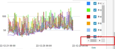

Thanks, to  @Rajkumar_20673, after a couple of tries following CSS worked:
/* ------------------------------ Legend width---------------------------*/
ptcs-chart-line::part(legend) {
width: 110px !important;
padding: 2px !important;
margin: 0px !important;

Not sure about hiding the scroll bar. But try to add custom CSS to modify the scroll bar size and color.
pshashipreetham
January 5, 2023
Hi @Sathishkumar_C ,
I tried it, but that will not affect Legend's Scroll bar.
Shashi Preetham || +91 8099838801 || shashi@psptechhub.com
January 6, 2023
Tried in Thingworx 9.3.4, custom CSS not working on Legend's Scroll bar.
It's seems, Thingworx 9.x widgets are designed with web components. Scroll bar CSS is not working on web components widgets.
