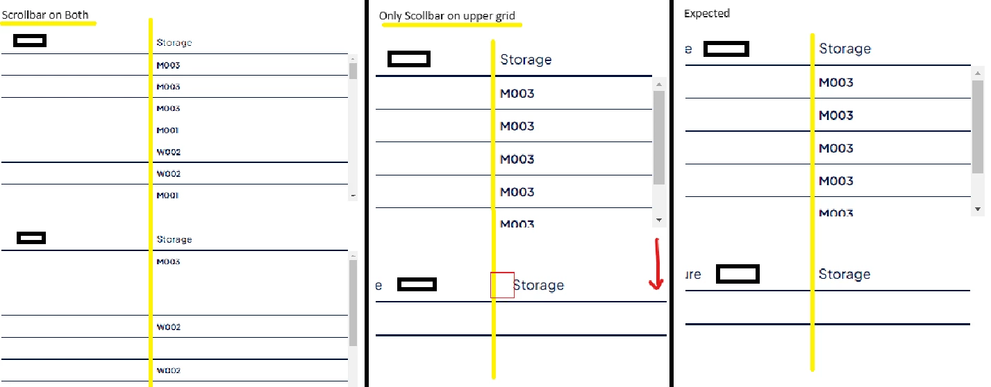

I have a problem with the vertical scrollbar on my grid widget (TWX version ThingWorx 9.3.8).
I have placed two grids vertically on top of each other, where the columns and their sizes partially overlap. However, when the vertical scrollbar is displayed on a table, the columns shift and it is no longer visually appealing.
The padding of the container (via Composer -> Layout) does not seem to have any effect on the grid.
Is there a way to use a kind of dynamic padding so that the area is reserved for a scrollbar?
Best regards
Marc

M4RC14-AlexandriteAuthor
May 31, 2024 7:26 AM UTC
Hello @pshashipreetham ,
All my columns have a fixed width set by % (percent),
because the number of columns in both tables is different.
The only option I have in this case is to set the width of the last column to 'auto width'. However, this does not change the behavior of the grid.
Best regards
Marc
