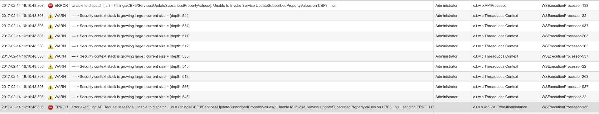

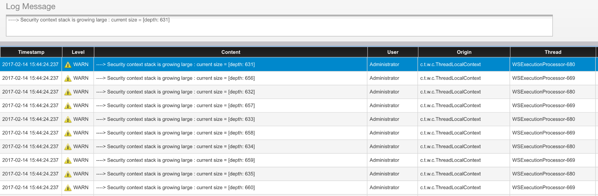

Hi Guys,
I have quite large problem. It is few days ago when this warning start to showing up in my Application log. It is very fast filling my Application log files.
I can see that the problem is coming from WebSocket subsystem, but I cannot find from where exactly.
We are using Kepserver + IoT gateway with Websocket agents.
But it worked without problems few months until know.
Is there anyway how to trace the source?
Tomas
Best answer by tcoufal
Found the problem.
I was heaving few subscriptions of DataChangeEvent and one was set on Property that I was changing in the same script. So it was stuck in a loop.
Stupid..
Luckily I was not the one who made that mistake , but it was more difficult to find.
Tomas

Do you have a connections server? Is there any other errors in the application log? What is your thingworx version?
tcoufal1-VisitorAuthor
February 14, 2017
We are not using a connection server. Version is 7.2.0.
There is only one (two) other errors in AppLog
February 15, 2017
Are the errors messages consistent with the warning messages? From the error message it seems that service is being invoked with some null data.
