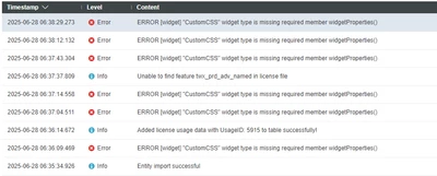

Building the sample project (as per the above tutorial) and importing it to the platform are completed just fine, however widget is not visible on MashupBuilder, and errors are thrown when MB loads.
ERROR [widget] "CustomCSS" widget type is missing required member widgetProperties()

AdamK_9313-AquamarineAuthor
Jun 28, 2025 4:43 AM UTC
Hi @PEHOWE ,
Thank you for checking. I've re-done the same, and after clearing browser cache and re-importing the widget, it does appear on the widget list in mashupbuilder,
The error was due to an another widget. Removig it solves the errors.
"ERROR [widget] "CustomCSS" widget type is missing required member widgetProperties()"
