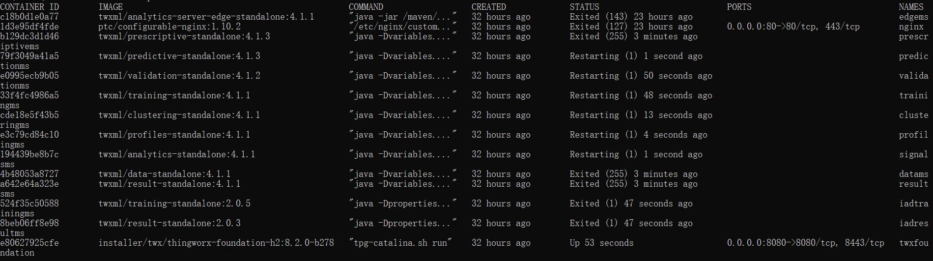

i work on I work on a local instance of ThingWorx 8.2 with ATE.
days before, i couldn't load the dataset,and i find it the reason was "Selected Analytics Gateway is not connected" in the setting.
i tried to reinstall ATE but it didn't work.and i have referred the article "https://community.ptc.com/t5/ThingWorx-Developers/Selected-Analytics-Gateway-is-not-connected/m-p/511980" and follow its step, but it is still not sloved.
what else can i do to solve the problem?
Thanks in advance.
Minnan

i am working on win10, and i install the ATE with the docker running.and i use AnalyticsTrialEdition-8.2.0-r3-windows-installer.
tell me if you need more details of that.
here is the ouput of the command docker ps -a
and the file is in the attachment

Ok so the docker ps -a shows that most of your contianer are ina Exited states, which means they are not running.
Among them is the edgems, thereofre this is why the gateway is not connected.
You will want to:
1) Ensure you have allocated enough Memory to the docker process:
For Docker for Windows , select docker Settings > Advanced > Memory and set at least 5 or 6 Gb
2) Stop the ThingWorx Analytics Trial Edition
3) check with docker ps, that no containers are running or starting
4) start ThingWorx Analytics Trial Edition
5) check with docker ps -a that no containers are in Exited status
Then access Builder
Hope this helps
