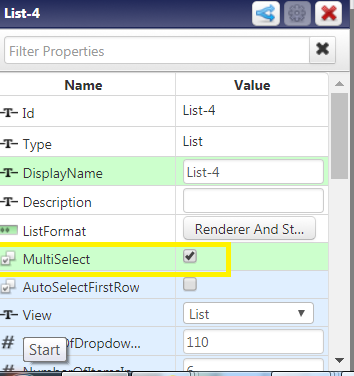

Hi. Can anyone explain me how SelectedItems in list widget works?
I have a list with severals items in it, so i need to select some default values and i can't figure out how to set the selected items; I know the widget has a "SelectedItems" option, but it doesn't work.
Thank You in Advance.
October 10, 2017
Selecteditems should have an infotable input.
October 10, 2017
Hi, Gautham. Thanks for the answer.. I know it needs an infotable.. Actually I pass an infotable as a parameter but it doesn't select the items.
October 10, 2017
If your infotable returns more than one row, try checking the MultiSelect option .
