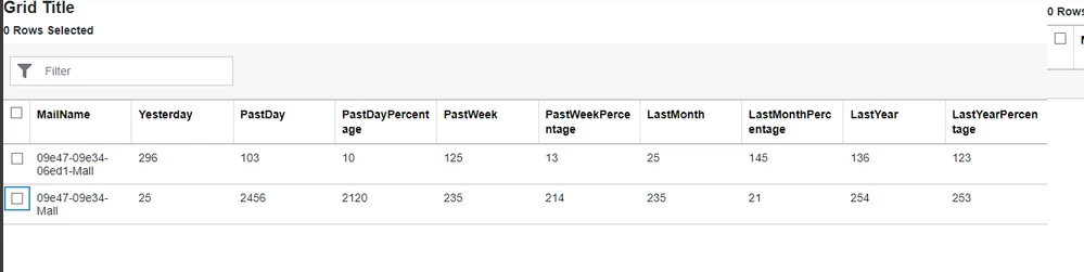

I'm trying to pass selectedRow as Input to the new grid in Thingworx 9.4 which is not working as expected
Steps to reproduce issue :

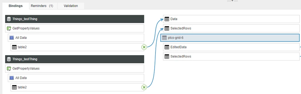

Step 1: Bind Data and SelectedRow Data to Grid
Step 2: Set RowSelection to Multiple
Step 3: View Mashup in Runtime
Default values not selectedDefault values not selected
As a workaround, I'm using an older version of the grid. But is there any way to fix this issue or am I doing something wrong here?

Update : Used InfoTableSelector widget to enable selectedRow on load as a workaround for new grid
