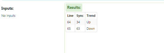

I would like to know how is it possible to select an info or data (cell) from a table?
for example if i would like to select Line = 65 ?

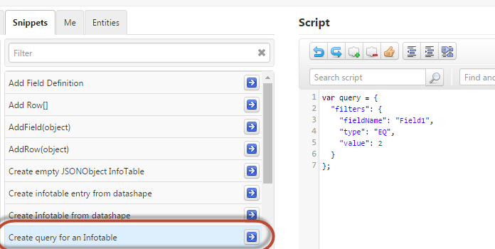

Karim, you can use the existing code snippet for the Infotable i.e. Create query for an Infotable something like this

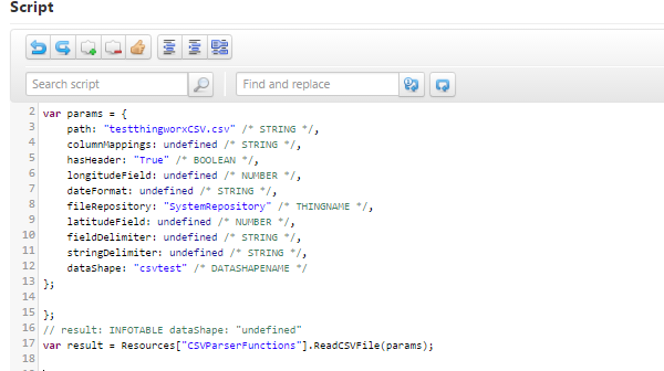

Thanks but i get the data from csv file as below :
so how after that i connect the query of calling one line or a certain value with this script? or create other service to do this ?

Karim, you can use the code snippet from Ankit, see his thread above, in your same service or mine whatever way you are comfortable.
However, you probably would want to query some other Infotables, so you can create a new generic service to avoid writing same set of code again and again - which can take Infotable as input, instead of overloading this existing one.
Then you can simply input your infotable that you are creating above or any other infotable to run your query on it.
Hope this helps.

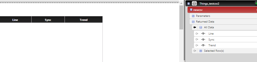

how can I simply select a certain data or line from a table on the mashup? as i don't know how to use the script above
the infotable name is the name of the service or the name of datashape?
Apr 6, 2017 9:28 AM UTC
Hi Karim BADR​,
Infotable is DataType. So, It cannot be a Service or a datashape.
Generally output variable of a Service is named result. This variable result can be of type Infotable.
To get a field of a row; just open the 'selected row(s)' option of your service and corresponding field be give us the output of the selected row.
