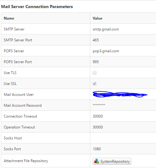

I am having issues with the mail server in the new 7.0 version of Thingworx.  I imported my mail thing, and it has all the same settings, but it keeps trying to send an email out of port 25(not the port I have in my settings) and fails every time.  Has anyone else experienced similar issues? Thanks!

Yes, I tried creating a new thing, based on the mail server thing template, and have it set up exactly like I do on my 6.5 Thingworx server.  I also imported my mail thing from my other server, and it had the same exact issue.  Here is the error I get:
Unable to Invoke Service SendMessage on MailNew : Could not connect to SMTP host: smtp.gmail.com, port: 25
Settings:

Brian, what is the configuration on that Thing? I created a MailThingTemplate based on the default MailServer and created a Thing based on my custom MailThingTemplate. I set the SMTP port as 80 on my Template and 8080 on my Thing. Now, if I tried sending a message from my Thing, it did take the port (8080) that I set on my Thing.
