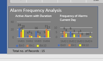

1. Is it possible to add dynamic series to a label chart, we can't define the number of series?
2. Is it possible to have two x axis in a single label chart? eg. In a station, we want to display the count of tags, In the below image SM01 is the station and in that we want to show Bit0,Bit1,Bit10 count as series. LabelChartExample.PNG

Hi @svisveswaraiya_285988.
In regard to your first question, the number of series cannot be dynamic.  It defaults to 8 but can be set to 24 out of the box.
For your second question, you can set a secondary Y axis but not a secondary X axis.
You may have to write your own custom extension for this if no one else in the community has a suggestion.  Please refer to this documentation for more information.
Regards.
Regards.
--Sharon
