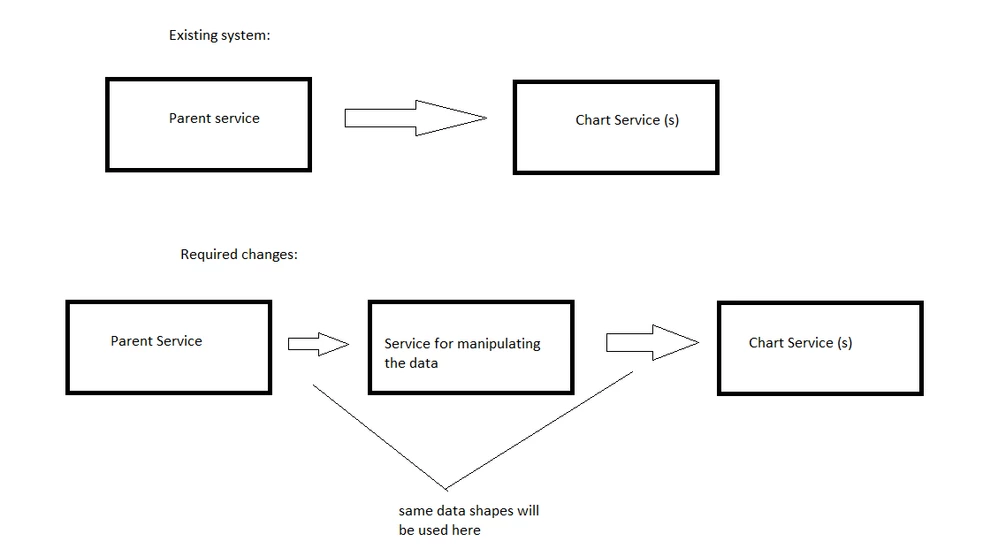

I currently have a parent service that provides data, the data we can refer to as 'objectData,' presented in the form of an infotable. This infotable contains numerous properties. The intention is to utilize this data in various charts, such as pie charts and bar charts. To facilitate this, I aim to create a mediator service. This mediator service will retrieve 'objectData' from the parent service, allowing me to manipulate the data. Subsequently, I can transmit the modified data back to the other services responsible for populating the charts.

Hi @AV_10867476 ,
Yes the above given scenario can be achievable by calling your "Parent Service" with all feilds & values in your mediater "Data Manipulate Service" with data manipulated for different charts by differentiating it in code level to print the output in required charts.
