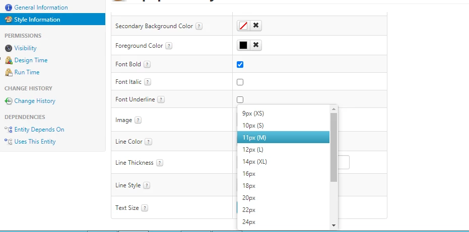

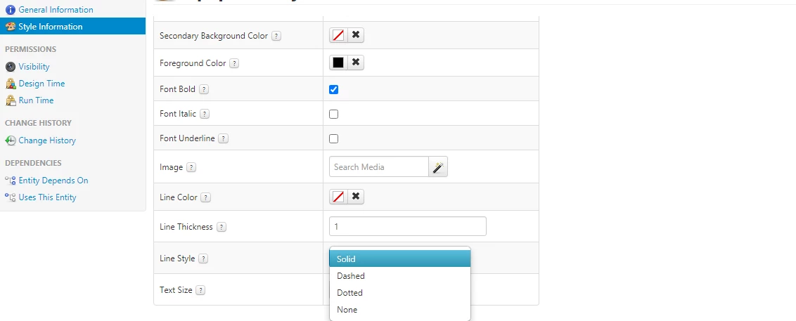

Hi Team,
How to display the default dropdown of "Text Size" and "Line Style" (which is present in every style definition) in a list widget (as dropdown) placed on a custom mashup? (Just don't want to write any loop and looking for any default api)
Is there any default service provided by PTC to list these two dropdowns present in Style Definitions for our custom purpose?
Files have been enclosed.
Thanks in advance.
zyuan1Answer
Jan 5, 2021 8:53 AM UTC
As far as I know, they cannot be changed in runtime. The style is always fixed.
But some widget will go with the browser setting, if the browswer uses bigger font size , mashup widgets (like Label) may also change
zyuan15-Regular MemberAnswer
