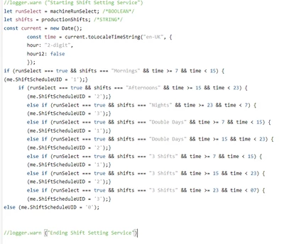

Hi I am still trying to learn java whilst trying to develop my thingworx app and I am trying to write a service to define the production shifts depending on if a boolean property is true and and shift has been selected from a drop drown (string) but services keeps failing saying specific shift (string) is not defined see image. Do I need to do a function call to return the string?

Fixed it now needed
const d = new Date();
let time = d.getHours();

Hello @Carl985 ,
Can you please share the error you are getting?

@Carl985
I reviewed your code and it seems fine. I also did a quick test and I am able to execute a similar service on my local instance.
Please enable debug logging in script logs and after replicating the issue again provide us the Script and ScriptError logs to check the exact cause.
