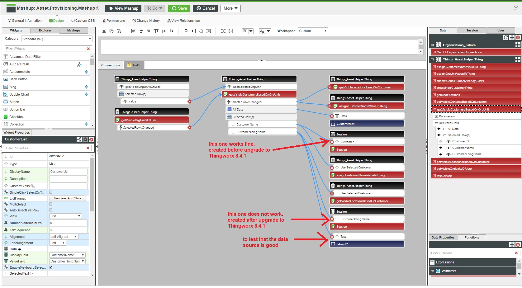

To test that it is not retaining value, I bound it in the following ways in the same mashup.  Nothing displays in the label.
1.  List widget (Service (SelectedRow(String))) ==input==> Session variable (String) ==output==> Label widget
2.  Textbox widget (Text (String)) ==input==> Session variable (String) ==output==> Label widget
When I bypass the Session variable, it works fine.  The label displays the string from list/textbox widget.
1.  List widget (Service (SelectedRow(String))) ==> Label widget
2.  Textbox widget (Text (String)) ==> Label widget

So you are saying that when you make a selection or type in the text box that is wired to the session parameter and then back to your label, they do not show the value that you input?
Or if you are checking actual retention, I would create another mashup that has
session parameter -> label and open that one after you've set the values
Willie16-PearlAuthor
March 14, 2019
"So you are saying that when you make a selection or type in the text box that is wired to the session parameter and then back to your label, they do not show the value that you input?"
Yes
I have a different mashup that I want to use the session variable for but since it wasn't working, I decided to test if it would even work in the same mashup.  I have other session variables that work but they were created before upgrading to Thingworx 8.4.1.  I'm not sure if it's related but after upgrading to Thingworx 8.4.1, new session variables do not seem to work.
Please see the attached.
