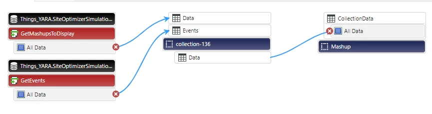

I'm passing an infotable from my parent mashup to the cell mashup using 'GlobalPropertyBinding' of the collection widget. I added in this property:
{"Events": "INFOTABLE"}
I added in my cell mashup the mashup property "Events".
But I'm not getting any data through... When there is in the parent mashup.
What am I doing wrong?...

Anyways back to english, the binding you specify should be the actual names of the parameter within your Dataset in the parent and the target mashup parameter name.
I can't tell exactly from what you are showing what the right names would be.
