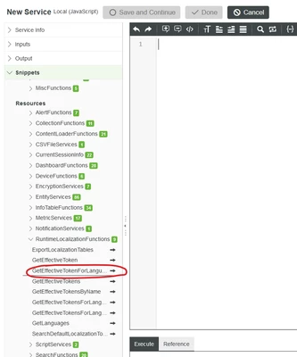

3. Are you saying how to get a token value in service? You can use one of following services, based on your need,

Hi @Vimal_Rawat,
Documentation per se is available here: https://support.ptc.com/help/thingworx_hc/javadoc/com/thingworx/resources/localization/RuntimeLocalizationFunctions.html
However typically we don't go there if we try to use those services, simply because the service editor in the ThingWorx Composer gives easy access to the services, in the Snippet section in this case, as @Bikash_Panda shared already. Hovering on them gives the exact explanations in the link above.
However, in addition to the Snippets, you can also choose to see in the "Me/entities" all the services of all the entities in the platform - also for Localization Tables.
