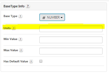

Hi all,
I'm struggling here trying to find a solution:
I need to set the value of Units programmatically while creating a new ThingShape, so far I haven't found a way to set it.
Is there a way to do this?
Capturar.PNGThank you.

Additionally, via the extension SDK this could be done like so :
		@ThingworxPropertyDefinition(name = "DemoTest", description = "", category = "", baseType = "NUMBER", isLocalOnly = false, aspects = {
				"minimumValue:10", "defaultValue:10", "dataChangeType:VALUE", "units:cm", "maximumValue:100" }) })
The values you are trying to set belong to the Class Aspects see JavaDocs
Hope this helps.

Please do note that at this time, the Units field is just metadata. it doesn't drive conversion of values.
They are also as you can see somewhat difficult to set and retrieve so they tend to not be exposed in the UI.
What is your use case for filling in the units? who will be seeing this information and using it?
