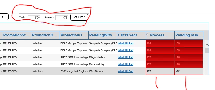

           i am looking for a service/snippet , when i give a input to it from mashup (number/Text box) i should be able to set state value, using which i will change style dynamically.
           Do we have something like that which can help me here.
         Any Solution/Suggestion will be appreciated.

You could look into state formatting. The style would change based on the value defined. Refer to State Definition here: http://support.ptc.com/help/thingworx_hc/thingworx_8_hc/en/#page/ThingWorx%2FHelp%2FComposer%2FVisualization%2FStyleandStateDefinitions.html

         Thanks for solution, yes that is what i was looking for but it solves my half the problem,
as selecting State for RowFormat can be applied on a row depending on single columns value only and in my case i want to apply dynamic state value on multiple columns.
           if i go with the configuration of TreeGridAdvance i can manage to apply state for All columns separately,
but in that case i will not be able to set State Value dynamically i believe.
