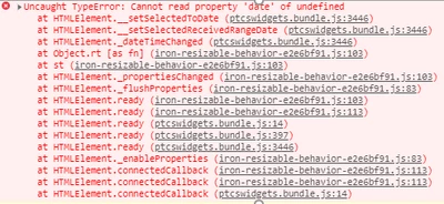

Setting the default range values of datetimepicker does not work
I am trying to initialize a DateRange datetimepicker with default start and end date and get following message in the console. Furthermore, the "done"-button triggers no event
See attached screenshot.
I am using ThingWorx 9.1.0
Thanks in advance
slangleyAnswer

Hi @AK_9796023.
As you know, a case was created for this issue.  The fix has now been delivered in ThingWorx 9.1.7.
Please test it out and let us know if you still have issues.  Otherwise, please mark this response as the Accepted Solution for the benefit of others experiencing the same issue.

Which widget is this?
6-Contributor
May 20, 2021
This is the Date Time Picker Widget(Type:ptcsdatepicker)
22-Sapphire I
May 20, 2021
You should be able to generate date time and bind that to the Widget Start and End.
