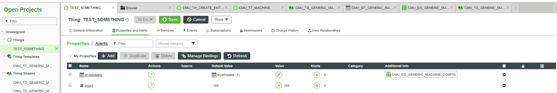

I have a infotable property in a Thing (Generic Thing), and I have set a default value to that Infotable property, but it is not reflected on Composer and even using service. However for other properties I can see the default value reflected as current value.
See attached screenshot.
I am using TWX 9.0.2. I am not sure if the behavior for Infotable properties was always the same.

As i tried getting more information here i come to know that this is actually working as expected. Let me try to clarify it more here :
So If you set something to persistent it will retain whatever value you have. If you mark a property as persisted (with a blank/ null value set), it will persist that value. You then changing the default value or adding a new default value will not matter because the set value is persisted (null in our case). The only reason you see default value getting reflected in non-persisted properties are because of the thing restarting (when you save).

Hi Om,
Here you can find the attached entity. It is a simply a generic Thing and has one Infotable property with datashape as NumberValueStream.
You can try to import it and then edit it to try to set the default value of the property.
But I think I understood the reason. Follow these steps -
PROCEDURE 1
Step1: Create a Property and set the default value of the property at the time of creation
Result: Default value is set properly
PROCEDURE 2
Step 1: Create a Thing
Step 2: Add a property (I think any type, not only infotable)
Step 3: Save the Thing
Step 4: Now again edit the Thing and edit earlier added property to set its default value.
Result: Now default value does not apply. I guess it is applicable for all types of properties and not just Infotables
I think this is a bug if procedure 1 is working and procedure 2 is not working.

Hello @amittal1
I tried both the scenarios on twx9.02 and In both the scenarios mentioned by you the problem is due to persistent properties.
Like if you have any property string or infotable( I tried on both ) and don't mark your properties as persistent it will work fine but in case you mark the property persistent we will get the issue mentioned by you.
For eg create a property (String) mark it as persistent and dont provide default values and save it . After edit if you want to provide the default values you wont be able to do so.
I will take it for further investigation to our R&D team . Thank you for reporting it to us.
