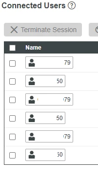

Hi All,
First post on the forum.
I was wondering if anyone could provide guidance on setting up Thingworx HA with a VMware Load balancer, similar to the Azure guide I found in the IoT Tips section.
I've used the following guide to date, which references a HAProxy config.
Load Balancers for ThingWorx High Availability (ptc.com)
What i'm finding is that I get SSO timeouts when navigating to the URL but only when the two Thingworx nodes are online during my testing.
When reviewing the connected users I see multiple sessions for my name, each time I refresh the SSO error I get a new session.
I understand through talking to PTC Tech support that this is a Load Balancer Persistence (Sticky Sessions) issue.
Tech support call raised with PTC and VMware to resolve, but if anyone has seen this before i'd be grateful to hear how you resolved it.
Thingworx HA Setup Version 9.3
Ping Federate (9.3.3) CAS / SP = ADFS
Thingworx Foundation x2
Connection Servers x2
Integration Runtime x2
Zookeeper x3
Ignite x2
Thanks in advance.

The team found that if we changed the algorithm used for the CXServer and Platform on the Load balancer pools to IP-HASH the problem was resolved.
