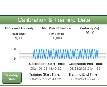

To test the anomaly detection with a simple use case I followed the steps in this guide, imported the anomaly mashup and to not wait for too long I updated the cmoTimer update rate to 50ms.
I didn't get to the stage of modifying, for example the sine amplitude, because prior to any modification the mashup showed me that is detecting as an anomaly the same sine used for training.

I looked at the Anomaly_Dashboard_Property mashup and I think that the difference in time is related to the FormatDate service (of the AnomalyServices thing) and that the server timezone is UTC and my browser timezone is UTC-3.
I looked at the FormatDate service, and the dateFormat string does not have the timezone into account.
I tried bypassing that service and binding directly to the Calibration Start Time widget and the time is displayed correctly (the format is different but the value is ok). Check the screenshot below.

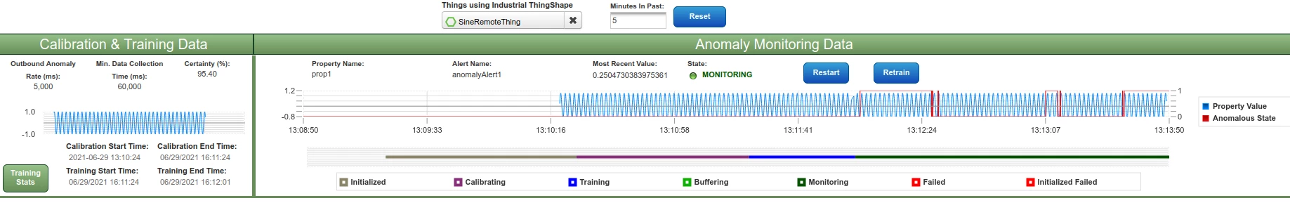

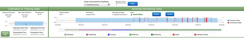

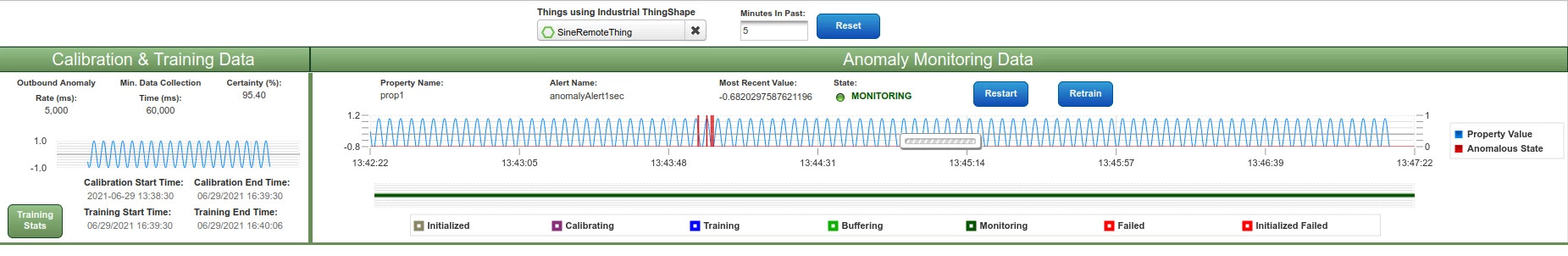

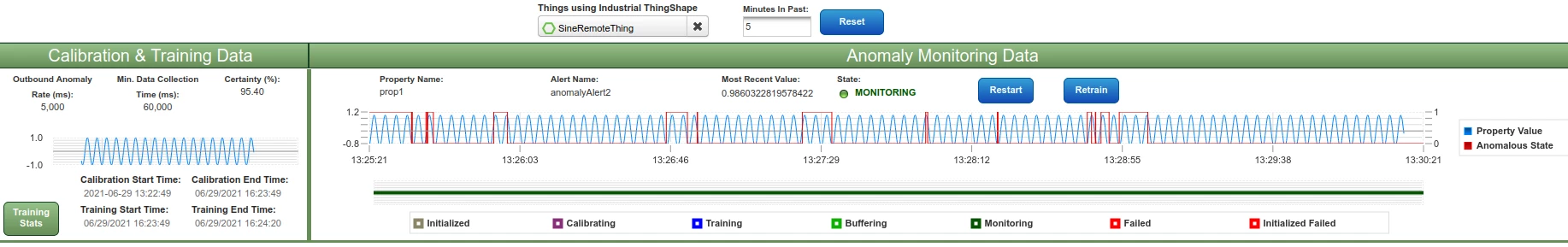

I repeated the test for 50ms (one more time), 100ms and 1sec - as the update rate value was increased (from 50ms to 1000ms) the number of false positives was reduced but there were always a few. Attached you can find the screenshots for each one.
