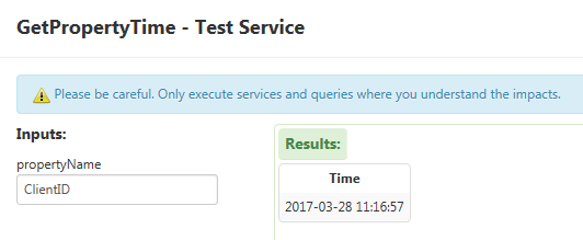

  • Use the GetPropertyTime service in Generic Thing Template, and bind it to the name of the property you are concerning about (or the property that's most often be changed), and it will return a time result. This service did not work for Remote Bounded properties, but you could create a new property that get updates from them.

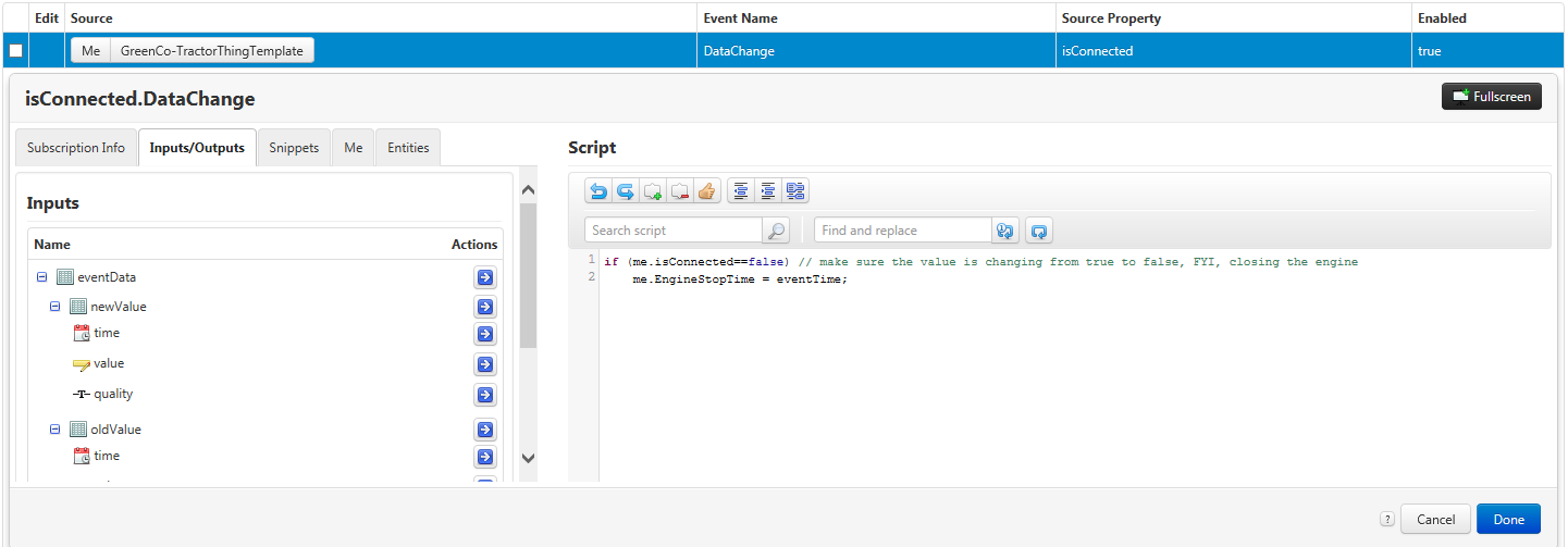

  • If the Thing is remote bounded, there would be a isConnected Boolean property, create a Subscription on DataChange event for it
    It returns the time when the connection is turned off.

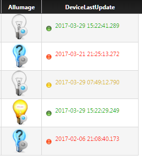

So I  have created a timer thing and I created a subscription to it  in the device template in which I'm testing the last update of the device
(I'm storing this in the device thing property)
It works very fine and very easy with simple code.
var today = new Date();
me.DeviceUpdateStatus =  "OK";
if ( (today -  me.DeviceLastUpdate) /1000  > 36000 )  // 10  heures
logger.error ( me.name + " pas de mise à jours depuis " +  (today -  me.DeviceLastUpdate) /1000  + "secondes")
me.DeviceUpdateStatus = "ERROR"
else if ( (today -  me.DeviceLastUpdate) /1000  > 3600 )  // une heure
logger.warn ( me.name + " pas de mise à jours depuis " +  (today -  me.DeviceLastUpdate) /1000  + "secondes")
me.DeviceUpdateStatus =  "WARNING";
and the mashup
following the recommendation, I could optimze the performances in the future with one thing to parse all device (using etImplentingThingsWithdata) when I'll have thousand of devices to manage
