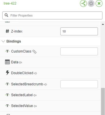

Hello everyone,
I have one Tree widget containing some items for selection. When I double click on any one of the item, a grid is displayed containing a list of devices that are part of that particular selection.
Now I want that this should be possible using single clicked event. But we have only "double clicked" event trigger  available for standard tree widget.
One of the way to do this is creating a customized Tree widget, having a single click event trigger instead of double click.
But by any way is it possible to find an alternate solution for this that doesn't requires creation of a customized widget??

May 26, 2025 3:47 PM UTC
There is no such event on the Tree widget. I have the same problem
