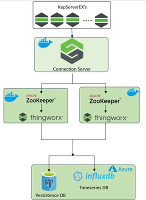

I look forward to doing a minimal Connection Server installation due to high traffic to the Thingworx Platform.
Present Scenario: 1 Thingworx Instance with 1 Postgres DB & 1 Influx DB
Required Scenario: 1 Connection Server with 2 Thingworx Platforms with 1 Postgres DB & 1 Influx DB
Can the required Scenario be achievable with 1 Postgres DB and 1 Influx DB for both Thingworx Instances? and is it a best practise?

With the help of @Jimwang and after lots of documentation searches on the PTC Knowledge base, concluded below.

Technically you can use one Postgresql for multiple Thingworx instances as long as the Thingworx instances are using different Database/schema. For example, your postgresql instance has two Databases dB1 and dB2, each Thingworx instance connects to its own database dB1 and dB2 respectively.
However, this is not a good best practices, especially for production system, for example, if you need to restart the postgresql, all the Thingworx instances are impacted.

Thanks for the quick response. Do we also need the Zoo keeper if we are using the Connection Server?

If your Thingworx Platforms are configured as High Availability Cluster, yes, it is required to install Zookeeper, otherwise, you don't need to use zookeeper
