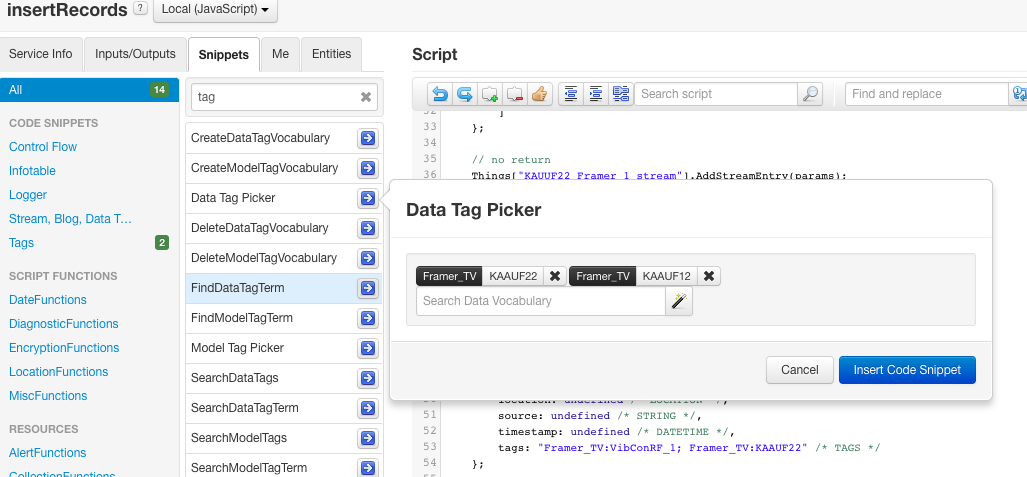

Hi Guys,
I have spotted an error in way how the DataTagPicker works in script.
it generates tags separated by comma. This actually creates a separate Term (if you have your terms dynamic).
It should be separated by semicolon or written like this:
tags: [
              vocabulary: "Framer_TV",
              vocabularyTerm: "KAAUF22"
              vocabularyTerm: "VibConRF_1"
Can anyone confirm?
November 10, 2016
Which version of ThingWorx and exactly which snippet are you using here?
tcoufal1-VisitorAuthor
November 10, 2016
TW: 7.2.2 b66. I have service that stores entry into the stream.
If I choose this under snippets, it returns (2 tags separated by comma):
"Framer_TV:KAAUF22, Framer_TV:KAAUF12", So 2 Terms from the same Vocabulary (Framer_TV) but if run your service it will create a new tag called:
"KAUF22, FramerTV:KAAUF12" inside vocabulary Framer_TV. If you separate it with semicolon it works as expected.
November 15, 2016
I can't get this snippet to work at all. Mine won't even let me select a data tag. I am in 7.2.4. You may want to open a support case for this issue
