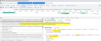

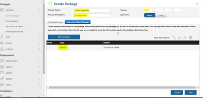

To find out which services to call you can go to the browsers DEV tools (F12) Network tab and have a look what calls are made. E.g. if you want to create an instruction based package like just follow the steps in the mashup with dev tools open:
´When pressing Save I can see the following request in the Network console
Now you know to "Save" a package you need to call on which thing which service http://flow.local.rnd.ptc.com/Thingworx/Things/TW.RSM.SFW.MashupHelper.Package/Services/CreateInstructionPackage and also which parameters.
For each step you do in the SCM you need to find the corresponding REST call. There are many calls which do things in the mashup but you only need the 'final' one to complete the step. There is no offical documentation stating which services you need for which step.
