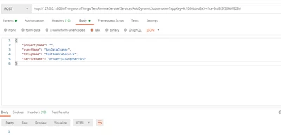

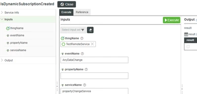

 I have added a dynamic subscription  by rest api and i check it out by call

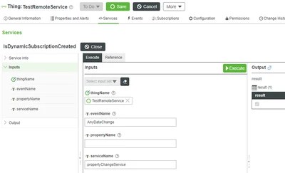

IsDynamicSubscriptionCreated ,it is yes ;but when i click save in the thingworx  thing page and then i recalled IsDynamicSubscriptionCreated  the answer is no ?

Hi @YC_10946483,
The Dynamic Subscriptions are created in-memory and are not persisted like a normal subscription (otherwise you would see them anyway in the Subscription page).
You just need to add AddDynamic.... call in the ThingStart event to make sure it's added to the Thing when it restarts.
