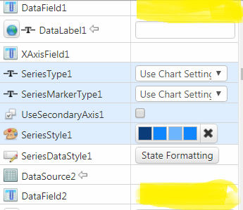

Hello Omar,
I don't know if I get it right. But you can do two aproaches:
- SELECT just the columns you want by the SQL Query in your service.
Or
- In the widget configuration, you can select the data to shown, select one or more columns of your infotable to be show in the Times Series Chart.

What I was trying to do was to feed the Time Series Chart with the result from a SQL query to plot the data. At first I was retrieveing all the data columns in a single query, but since there are diferences between the value ranges of the variables the chart looks awkward also the number of variables to plot  is greater than the 8 time series that this widget support.
At the end I created a SQL service that takes the variable/property name as a a parameter to retrieve only the data for that column from the database and pass the result to the chart, that way the service is dynamic and I´m only using one chart to plot all the variables.
I'll try a solution similar to what Sushant Pandey proposes (there is no materialized views on MySQL/MSSQL) in the meantine I think that I'm OK with the result so I'm going to close this thread.
