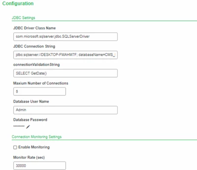

I am not getting any error in logs,specific to Database configuration but still i am unable connect to the SQL Database.
i already worked with this Database, but this system is different so i am trying to connect. please see below snaps which i configured.
Instead server name i tried putting 'localhost', 'ip Address' but still not.

Your connection string is missing the port number, by default 1433 - it might not work if you changed that default port.
Also you need to ensure that SQLServer is configured to serve a static TCP/IP port, see https://www.ptc.com/en/support/article/CS263390.

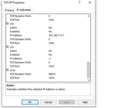

I tried both by putting 1433 as port and enabling TCP/IP or Enabling all ip ,also enabled named pipe.
but still not connecting..and still not getting any related error.
