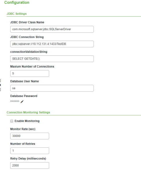

While trying to connect to the SQL database from thingworx . saying Thing is not running . plz check attached configuration file. actual database is at local machine and running thingworx is at another Machine .thank you

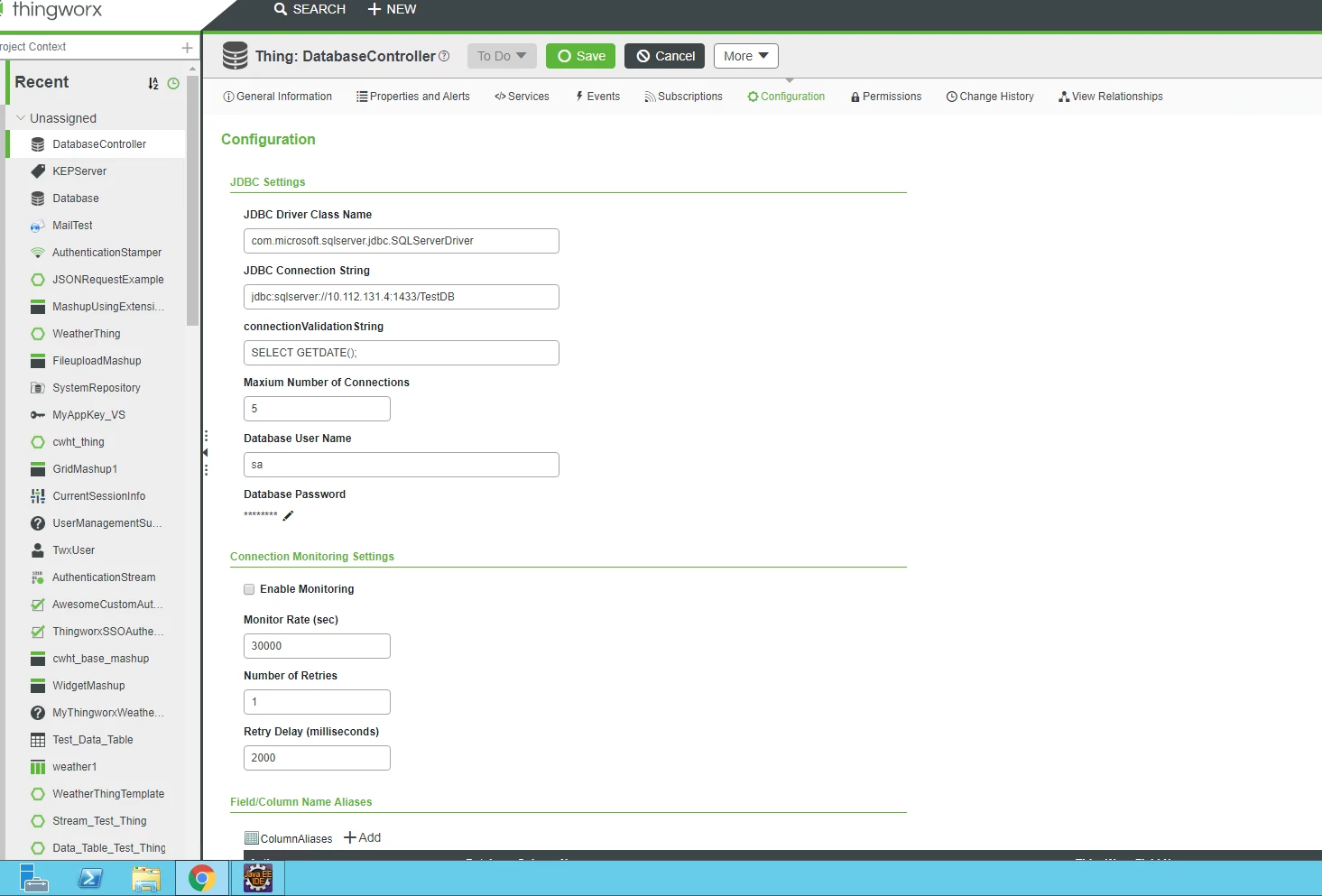

Hi Pai,
Thanks for reply , i tried with adding driver file to tomcat lib folder. it worked

Thing not running would refer to this entity itself not the database you are trying to connect to.
Try doing disable / save / enable / save see if that helps at all.
Thanks for reply , I am unable to see any option like enable or disable the thing. would you explain little more .
shared screenshot , plz check it.
thanks
yes , i got the services enablething and disablething , executed . but still having same issue
