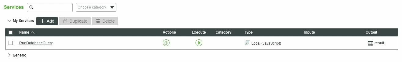

Hi, I am trying to make a query to an sql database. I have Thingworx 8.4.2 and I don't find the option to make an SQL type service, only javascript. I wrote the following code:
"try {
var query = "SELECT * FROM `info`";
logger.debug("DatabaseController.JavaScriptQuery_PersonsTable(): Query - " + query);
var result = me.RunDatabaseQuery({query:query});
} catch(error) {
logger.error("DatabaseController.JavaScriptQuery_PersonsTable(): Error - " + error.message);
In the application log I get the following error:
[O: c.t.s.a.AuthenticationFilter] [I: ] [U: ] [S: ] [T: http-nio-8015-exec-7] Servlet execution threw an exception
Do you have any solution? Thankyou very much !

Hi @BSUN_RO,
You can run SQL queries from a ThingWorx service by creating a Thing with Thing Template "Database" assigned and connecting to an external database using the Configuration tab of that Thing. You will find at the following link some JDBC Configuration Examples. Once such a Database Thing is connected to your database you can create and run services of type SQL (query) and SQL (command) :
You can also refer to How to connect ThingWorx with an external database without extensions.
BSUN_RO1-VisitorAuthor
Jan 25, 2021 8:52 AM UTC
I don't have a dropdown button to select SQL.
Jan 26, 2021 8:16 AM UTC
The dropdown list is not available for Things based on Templates like GenericThing :
It is only available for Things based on the Database ThingTemplate :
Which ThingTemplate are you using ?
