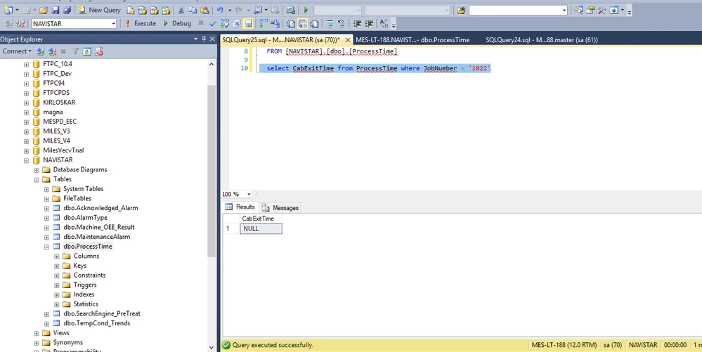

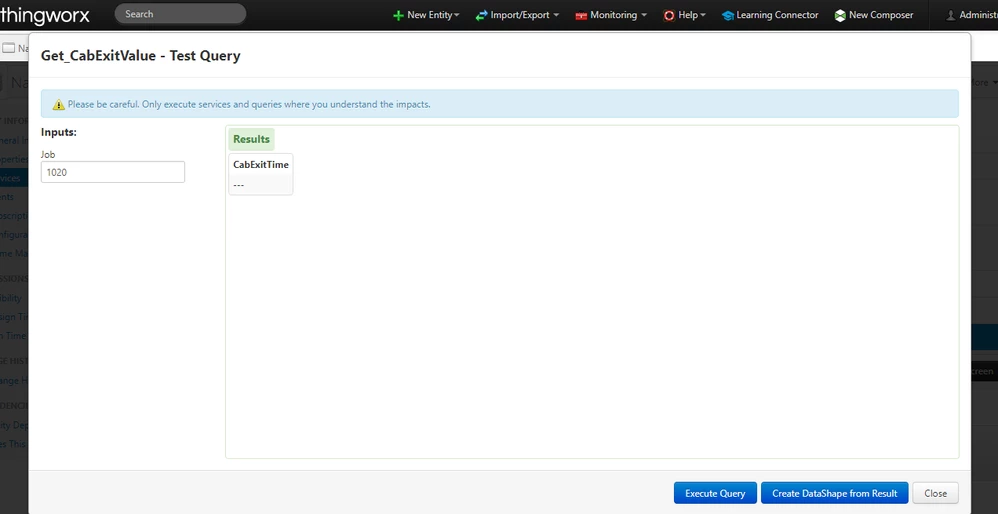

When I execute a simple sql query,
"select CabExitTime from ProcessTime where JobNumber = [[Job]] "
I am getting result as "---"
My base type is infotable.
Please help me to know where I have gone wrong.

That could mean Null in infotable result, you can assign this result to a Grid widget, and see what you get.
November 12, 2018
It seems like the MS SQL query already returns NULL.
This is the result ThingWorx receives as well.
I'm not sure about the query itself, but you could try unquote the number.
Is there any value in the table for this process number if you look it up directly? Just opening the table, viewing it - not with a query.
