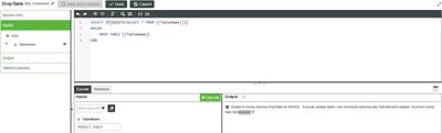

Any idea about why SELECT IF EXISTS command is not working.

Syntax is not correct. Please check this link: https://stackoverflow.com/questions/7887011/how-to-drop-a-table-if-it-exists

Hello Naeem,
You can't use [[abc]] as placeholders for table names, only for parameter values. It's a rather frequent question, here's another example: https://community.ptc.com/t5/ThingWorx-Developers/Problems-with-the-input-parameter-in-the-SQL-query-service/m-p/618832
Constantine
18-Opal
February 7, 2020
Just to be precise -- it is technically possible to use <<abc>>, which simply replaces strings in your SQL statement, so you can use it anywhere in your service (unlike [[abc]], which works as PreparedStatement parameters). However, this makes your service vulnerable to SQL Injection exploits (e.g. https://portswigger.net/web-security/sql-injection), so you should be very (VERY) careful with that. Make sure you only expose this service to System user and wrap it in another one, which thoroughly validates its parameters. If you don't do it -- somebody might be able to steal your credentials, drop the entire database, etc. etc.

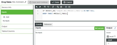

Still not able to drop the temporary table according to the link that @raluca_edu mentioned in her comment.
Moreover, according to @Constantine I'd like to avoid using query as a string.
Basically I've a query in which I'm using both DDL and DML functionality. Is there a way of implementing it.
I'd like to use the following single query which works fine, not in thingworx.
