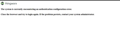

I am working on SSO SAML integration with Thingworx 9.3.4 using OKTA. and stuck with the below thingworx error apperating in Application log.
Need advice on what might be the issue. I have double checked and validated the path, permission, password mentioned in KeyManagerSettings json parameter in sso-settings.json file.

2025-09-19 13:31:13.510+0530 [L: ERROR] [O: c.t.s.SecurityManagerBootstrapper] [I: ] [U: SuperUser] [S: ] [P: ] [T: main] Unable to load SecretProvider, {}
2025-09-19 13:31:13.510+0530 [L: ERROR] [O: c.t.s.SecurityManagerBootstrapper] [I: ] [U: SuperUser] [S: ] [P: ] [T: main] Failed to create SecurityManager, Failed to load SecretProvider

2025-09-19 13:31:13.523+0530 [L: ERROR] [O: c.t.s.ThingWorxBootstrapper] [I: ] [U: SuperUser] [S: ] [P: ] [T: main] *** CRITICAL ERROR ON STARTUP: Severe error in Custom Context Loader Listener: Failed to retrieve SSOContext

Thanks for the link, but this issues was related to temporary files that gets created during TWX service start in ssoSecurityConfig folder. I removed the them are restated, the service is starting successfully. But ever after the SAML authentication, the Thingworx page is redirected and stuck here.
Any Idea on what's causing this ?
There is no error in SAML response by the way. I checked using SAML Tracker .
Thank you.

There is another article which you should review as well.  Article - CS376069 - While configuring ThingWorx for SSO encrypting passwords fails with the error "Error initializing from keystore.conf, Failed to create SecurityManager, Failed to load SecretProvider"
Please review and let me know if this helps
Pehowe
Support
Sep 26, 2025 12:49 AM UTC
Hi @SV_10197221,
Are your passwords encypted in sso-settings.json? If so, set the passwords as plain text and see if it resolves the issue. Then follow the Help Center to re-encrypt the passwords if needed.
