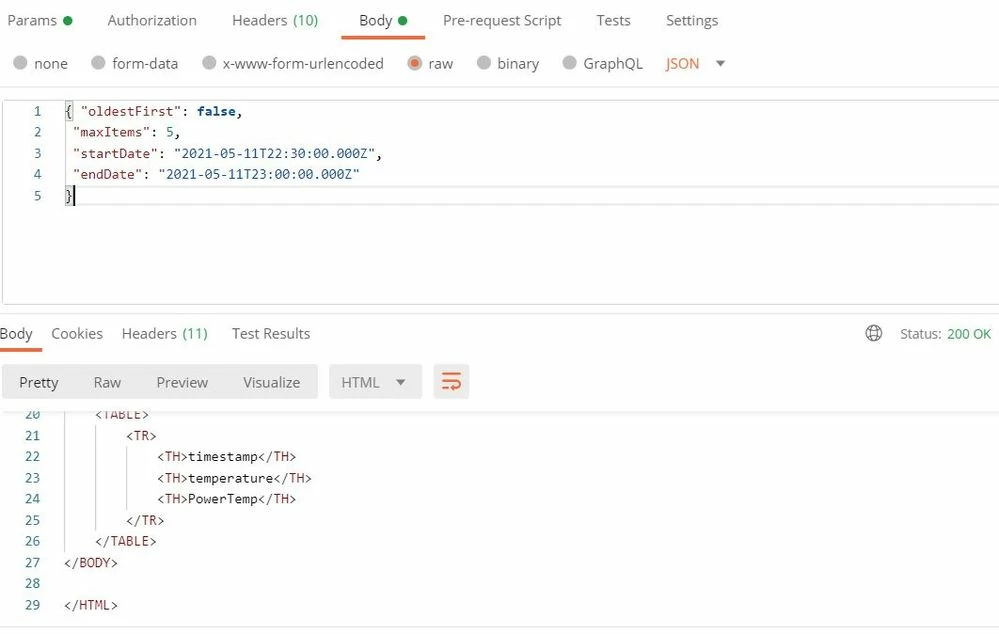

I would like to use postman to test called service QueryPropertiesHistory
On Thingworx 8.4

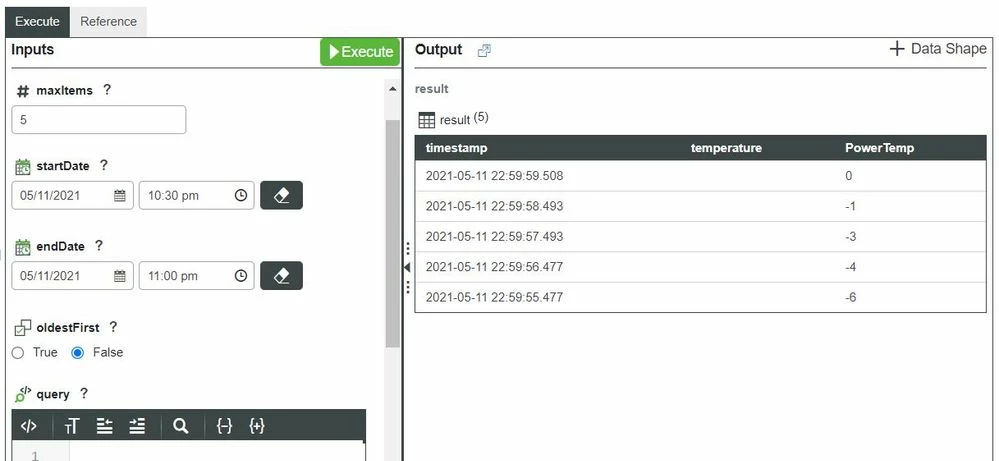

first, I try it on thingworx like
When i try it on Postman is like (Only raw body)
Value does not show
I think it may about format on startDate and endDate
How the format should be on postman
Thank you
{ "oldestFirst": false,
 "maxItems": 5,
 "startDate": "2021-05-11T22:30:00.000Z",
 "endDate": "2021-05-11T23:00:00.000Z"

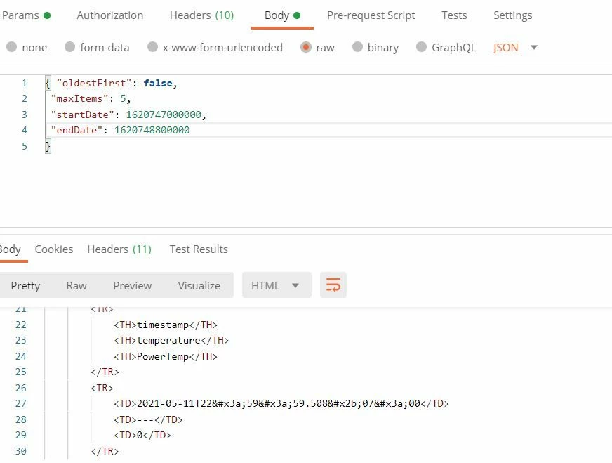

You can try to use web site https://currentmillis.com/ to convert date to numeric milliseconds (like {"startDate":1620223200000, "endDate":1620743400000}), and pass the parameters as JSON in postman.
